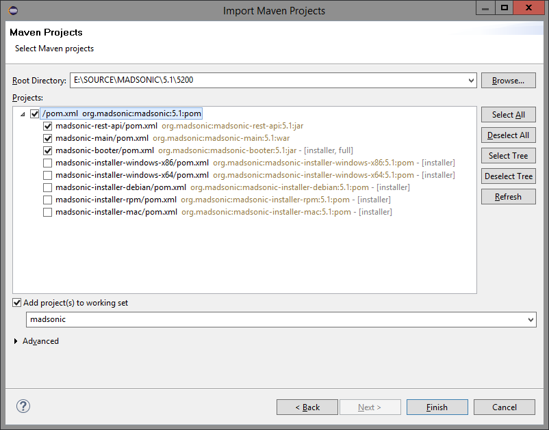

* Create IDE workspace
* Import project -> Maven -> Existing Maven Projects -> select source folder
Depending of your OS this can take a while (depending source code library's 600MB - 1.2GB)
try to build the project.

Re: Madsonic Development in Eclipse [Help]
Unread postby chupalo » 13 Sep 2015, 21:10
Madevil,
I appreciate the reply immensely.
I followed your directions and things look promising but I do have a few errors. I'm not certain in what order these might be important so will quickly list them out. I also could not find a mention of which Maven version I should be using, but am on 3.3.3 if that should make a difference. Java is 1.8_51.
Maven Dependency Problems
Missing artifact
- org:jaudiotagger:jar:2.0.4-SNAPSHOT pom.xml /madsonic-main line 279
- org.directwebremoting:dwr:jar:3.0.0-rc3-SNAPSHOT pom.xml /madsonic-main
Maven Problems
- Plugin execution not covered by lifecycle configuration: org.apache.maven.plugins:maven-antrun-plugin:1.7:run (execution: default, phase: generate-resources) pom.xml /madsonic-main line 407 Maven Project Build Lifecycle Mapping Problem
- Plugin execution not covered by lifecycle configuration: org.mortbay.jetty:jetty-jspc-maven-plugin:8.1.16.v20140903:jspc (execution: jspc, phase: process-classes) pom.xml /madsonic-main line 474 Maven Project Build Lifecycle Mapping Problem
I feel close! :-)
Thanks again
- CL
Unread postby Madevil » 13 Sep 2015, 22:06
chupalo wrote:Madevil,
no, that's ok.
chupalo wrote:Maven Dependency Problems
Missing artifact
just simply copy the repo folder to your local repository
chupalo wrote:Maven Problems
I feel close! :-)
Thanks again
- CL
mark this goal as ignored with eclipse build, just do the trick. :D
