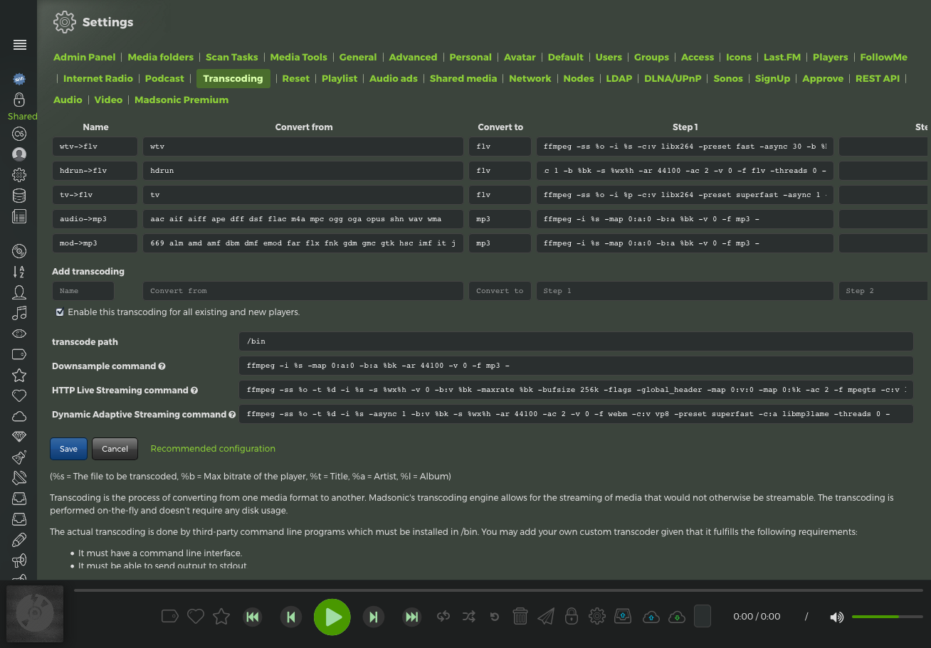

Re: WARNING no transcoder found!
maybe you need to put the ffmpeg into the path?
can you reach it on the console, just typing ffmpeg --help in your home-directory?
this is what my settings look like:
check: transcode path
Downsample command
ffmpeg -i %s -map 0:a:0 -b:a %bk -ar 44100 -v 0 -f mp3 -
HTTP Live Streaming command
ffmpeg -ss %o -t %d -i %s -s %wx%h -v 0 -b:v %bk -maxrate %bk -bufsize 256k -flags -global_header -map 0:v:0 -map 0:%k -ac 2 -f mpegts -c:v libx264 -preset superfast -c:a aac -b:a 96k -strict -2 -threads 0 -copyts -
Dynamic Adaptive Streaming command
ffmpeg -ss %o -t %d -i %s -async 1 -b:v %bk -s %wx%h -ar 44100 -ac 2 -v 0 -f webm -c:v vp8 -preset superfast -c:a libmp3lame -threads 0 -
audio->mp3:
ffmpeg -i %s -map 0:a:0 -b:a %bk -v 0 -f mp3 -

Thanks for the help! I had the wrong transcode path...
Changed it and everything is ok. :)
