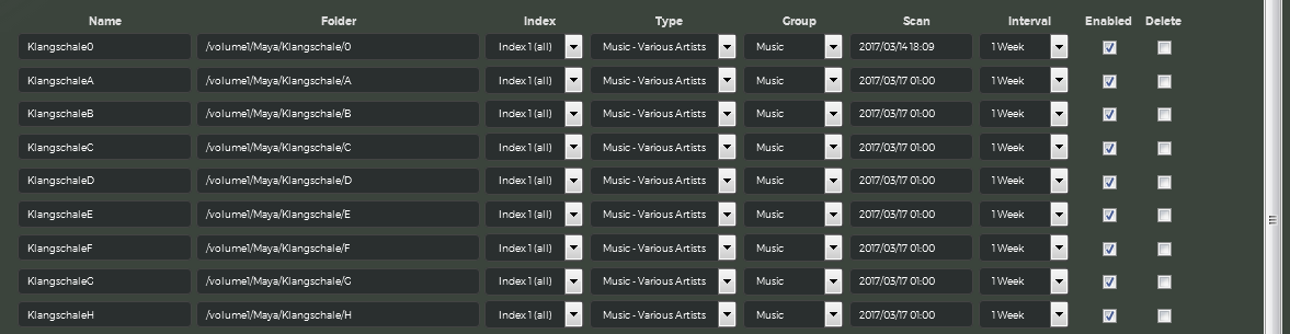

I have turned off the
[ ] Fast access mode
after setting up the mediafolders scan intervals before a week, i wanted to test, if the interval and the rescanning of media files is working properly.
it is not.
madsonic seems to scan the media folders, but no new media is added to the recently added page, or history or new100 or anywhere else, including the search results.
We have added plenty new media during the last week, so it should show something new on the recently-added pages, but it shows the same old stuff since a week.
(Madsonic does NOT show any new media added the last week, BUT shows newly added albums, when using the search, and opening the artists page of artists which were in the database before adding new media for those artists. After that, those albums only are shown on the recently-added-list) (this behaviour of madsonic is confusing and not userfriendly, but its a workaround to play newly added media)

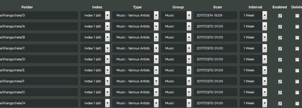

This are my settings for the media folders:
media folders before running the automated rescan

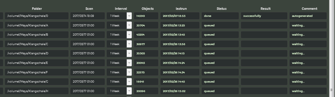

This was shown, during the automated scan:
media foldes during the automated scan
This was shown after the scan had finished.
media folders now being updated/rescanned
This was shown in the log:

[2017-03-10 22:49:24,130] DEBUG MediaScannerService - WATCHDOG:TIMER: UPDATED [testing]
So everything seems ok, but it isnt.
Is there anything I can do to have madsonic scan the media folders as expected by a usual user? (set up an interval for scanning, scan for new media automaticly, add new media to the library, show new media to the user via i.e. recently-added-list)
EDIT:
I changed the interval of all the media folders to 1 hour and it helped a few hours. Newly added albums were added to the list (not all, but most) but now again, after some hours, no new media is added anymore. The log shows nothing interesting. Everything seems normal, but it isnt.
This is a showstopper!
A music server/player which is unreliable and cannot keep track of all added music is quite .... odd. nicely spoken :-)
EDIT2:
After changeing the interval to 10 mins, no media were added too. But while stopping the madsonic service, those errors popped up:
