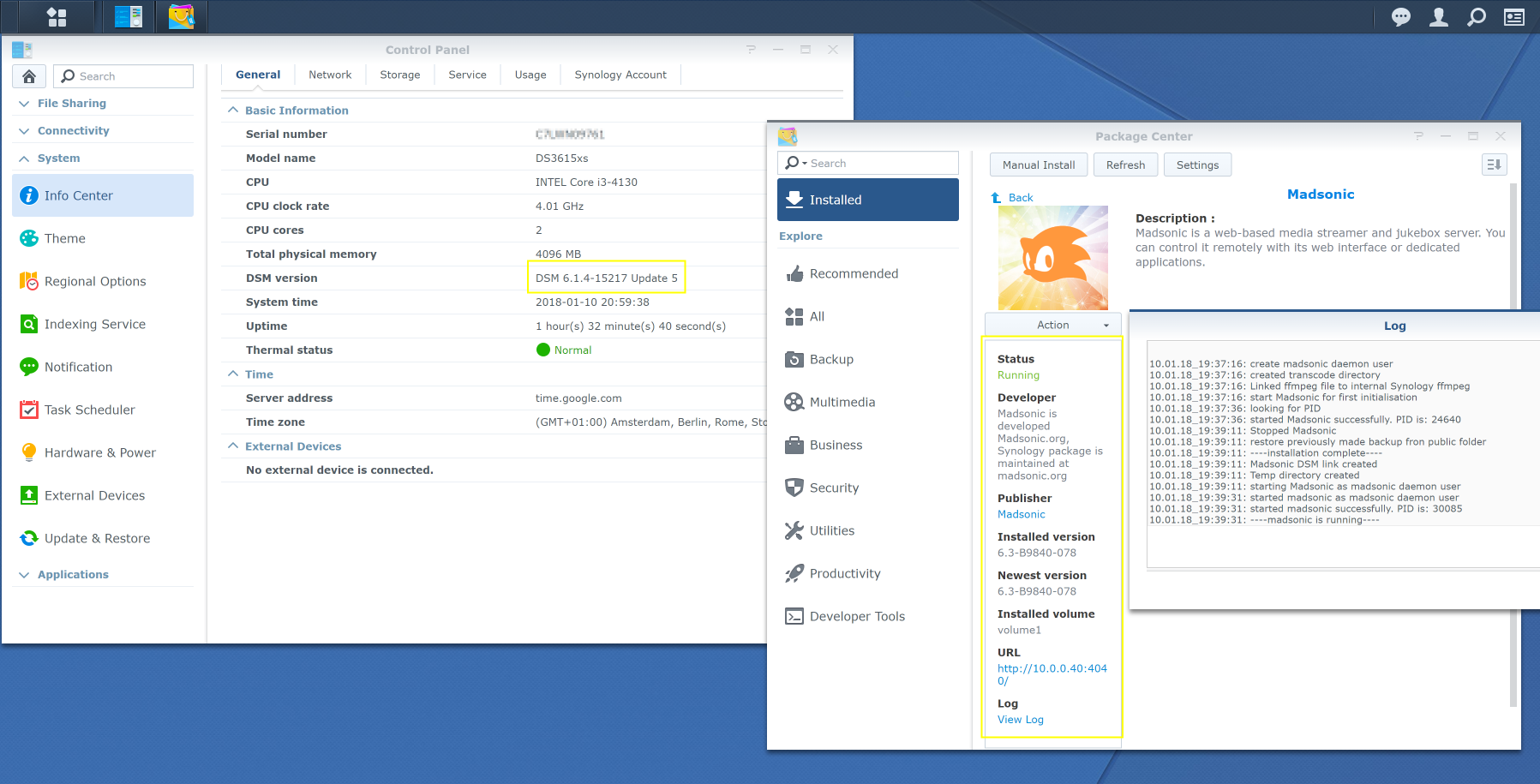

here are some screenshots of the latest test installation on a Synology 3615 with DSM 6.1.4 and Madsonic 6.3.9840 installed.
* Check on the about page, if you have a working ffmpeg version (version in green is ok | error message in red)!
* Don't forget to set the permission on you media folder for the madsonic service account!
